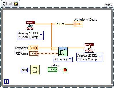

Hi Milon,
use the array type of the "PID Advanced":
You see all those thicker wires: these are arrays! 😄

Hi GerdW,
Thanks for your quick response. 1 last question.
"Do I need to use Arduino circuit (Like UNO/Mega) for this code? I feel easy in NI USB 6009". Above code shows some errors.
