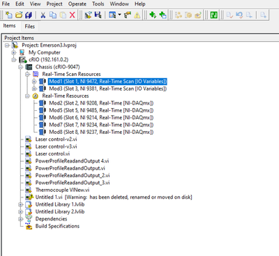

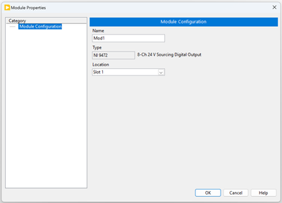

I am trying to use the 9472 module to create a PWM output and when I select the properties option to set the module in specialty digital configuration, the mode does not appear on the pop up (2nd picture attached). I checked and this module should have this functionality according to: https://knowledge.ni.com/KnowledgeArticleDetails?id=kA03q000000YIUWCA4&l=en-US. I am connecting the module to a cRIO 9047.
Is there a problem I am not seeing? Can you help me?

why don't you place the NI9472 into the DAQmx resources and use DAQmx to output your PWM signal(s)?
