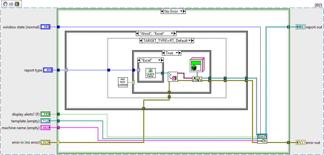

The Report Generation Toolkit uses a plugin architecture:
Since the class is not statically declared on any block diagram (it's dynamically loaded), you have to include the files in the build spec for the packed library. If they're missing, I would expect to get the behavior that you are currently experiencing.
