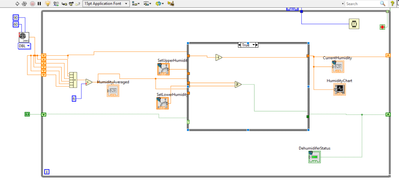

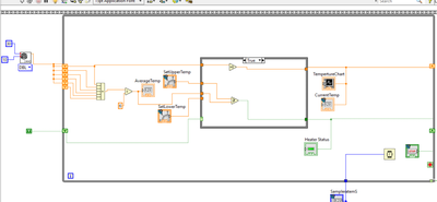

I have project to where I have to detect Temperture and Humidity concurrently, and adjust them.
In my VI the Temperture While loop is working as hoped, but the Humidity While loop wont even start/Initialize. Any ideas to help. Any help would be greatly appreciated.

Hi Bandit,
The answer is quite simple: THINK DATAFLOW!
You did not follow that basic LabVIEW mantra, and so the loops will not run in parallel!
This becomes easily visible once you use the AutoCleanup button!
Why do you need two loops at all? Why not place all into just one loop?

Hi Bandit.
your images look different than the block diagram of the attached VI, so you edited it in the mean time!?

I never used auto clean before. Very very useful tool.
I can see the problem with the stop button now.
Thanks very much. Much appreciated.
