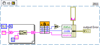

I'm not sure I understand why you want to absolutely use an error cluster. Using 3 separate variables would definitely work. The only issue is with the string. You need to allocate the space in Labview prior to calling the DLL, and copy the string (not the pointer) into the Labview string, using strcpy() for example. You allocate the memory in Labview by creating a string with the number of characters corresponding to your length limit.
The code in the DLL would look like:
int TestCluster(char status, int code, char *source)
    code = 1;
    status = 0;
    strcpy(source, 'Test');
return (1);
Marc Dubois
