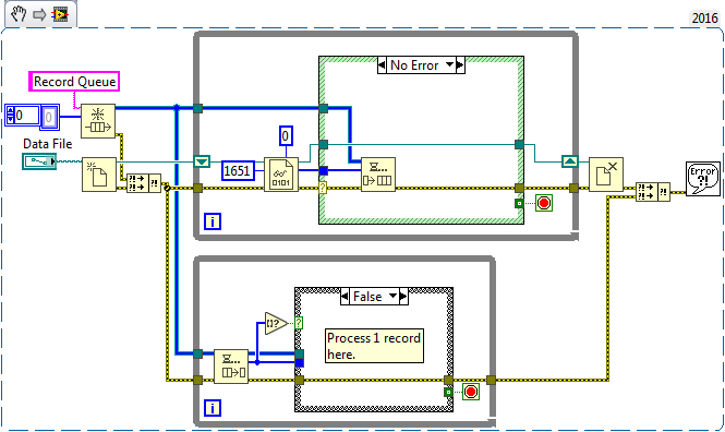

I've tried to implement it using Producer/Consumer example, not sure if I'm approaching it correctly. I'm trying to read from a file (also attached), and read each individual value. Please let me know if I'm implementing it correctly, I'm not getting the desired results.
Message 5 of 13
(9,387 Views)
In your "producer" loop only 1 element would ever get enqueued.  Try replacing your while loop with a for loop and use indexing.  That way each loop iteration you will send a single 1D array until you run out of data.

Andrea,
     What are you trying to do, and when are you trying to do it?  [Echoes of Watergate ...]
     You have a file that we've discovered can be read as a binary file having "records" that are 1651 bytes long.  You have a number of options open to you on how to process this, with "Time" and "Space" being variables in the equation.
  1. Read the entire file into memory.  Use Reshape Array to make an array of N "Records".  Process the Array one record at a time by passing it into a For Loop using an Indexing (default) tunnel.  Requires the most Space, Time moves sequentially.
  2. In a While Loop, read a record (1651 bytes) into memory.  Process the record.  Stop when you reach End of File.  Requires minimal Space, Time still moves sequentially.
  3. Use Producer/Consumer.  Producer Loop reads a record and puts it on Queue, continuing until EOF, at which point it puts a Sentinel (an empty record) on the Queue and exits, leaving the Queue intact.  The Consumer, running in parallel, waits for a Record, then processes it.  If it was the Sentinel, the Consumer exits and Releases the Queue.  Space is intermediate (depends on relative speeds of Producer and Consumer), Time is used optimally (Producer fills gaps when Consumer is "busy", Consumer fills gaps when Producer is "busy").
I don't know why you would need one method or another, as the nature of the processing isn't clear (to me -- you may have described it earlier and I've just forgotten).  I tend to use P/C when I have a Producer that spends a significant amount of time "waiting for data" (such as an A/D converter producing 1000 samples at 1KHz continuously -- it is very busy, but spends 999 milliseconds "waiting for data to be available" and 1 millisecond giving me the data, so with P/C, I spend those 999 milliseconds processing the data I just received, keeping the CPU busy.
To help illustrate one way of using P/C with this project, here's one way to use Queues to process records, as in Step 3, above.  I realize you are using LabVIEW 2013, and thus can't use these directly as Snippets, but I'm hoping that they are simple enough you could create them "from scratch".  I've also included the other cases for the two Case Statements as they contain "important" code, namely the Sentinel code.  Note also that arranging the parallel loops in a vertical column gives a subtle visual impression that they happen simultaneously, rather than sequentially.

OK, if you take my code and put a Wait function, say with 1000 wired to it, you will read one record a second and pass it on to the Consumer for processing.
But why do you want to do it this way?  Are you trying to simulate something that spits out 1651-byte records at regular intervals?  Where does the need for parallelism come in?  If we call the code "inside" the Producer loop "Read A Record.vi" and the code inside the Consumer loop "Process A Record.vi", what's wrong with a For Loop containing Read A Record directly connected to Process A Record?  True, you are doing these two operations in series rather than in parallel, but I don't see a compelling reason to add the extra code to create a parallel design.  [Of course, I don't see your Big Picture ...].
