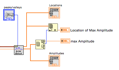

@HateF something like this but i need the peaks so i can it likewise this dont pick the highest of the peaks right ? it just read the signal which has the signal itslef
Message 23 of 40
(2,677 Views)
Here is how to modify your VI to find the highest peak and its location.  I have not tested this because I do not have all of your subVIs or any data.

may i know what the thing  that connected to the location of max amplitude ? i could not find it in the array list
Message 26 of 40
(2,589 Views)
Index Array.

The arrays (Amplitudes and Locations) at the output of the Peak Detector in the VI I posted have exactly the information needed to plot the highlighted poitns in peaksss.png.
Beyond that I am not sure what you are wanting.

location of max aplitude and max amplitute is created by indicator or using other tools to do it becasue i tried using number control tools it could not let me connect in
