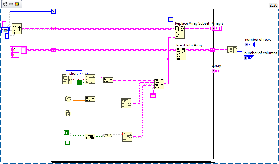

like this? "replace subset" is faster when the arrays are getting bigger.

I just did this and I stopped getting the performance decrease.
Thanks.
