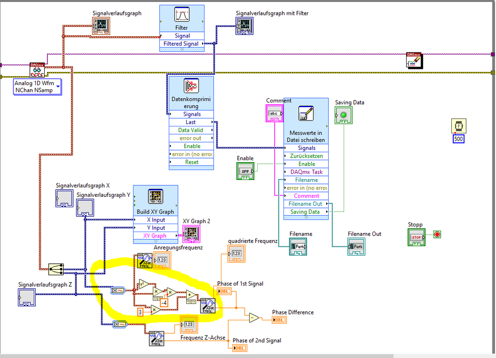

for an experiment I use an accelerometer which records the accelerations in three spatial directions. From two of these axes I get a sinusoidal signal. I want to determine the phase offset of the two signals. The signals have different frequencies, which are a multiple of each other. For example: Signal 1 = 20Hz; Signal 2 = 40Hz.
I have created the VI according to a similar instruction from the forum. The circuit works for the same frequencies for signal 1 and signal 2, but not for different frequencies.
For any help I would be very grateful

thank you for your reply. It is exactly what I am looking for. In my case, the frequencies are always integer multiples (harmonics) of each other.
I am not sure if I understood your solution correctly. I have now multiplied the signal 1 (20Hz) by itself. What do you meant by removing mean? Do I still have to derive my sinus signal for your solution into a cos function?
A new image is attached, with this adjustment I get a stable phase shift (the phase shift does not jump now like before), but it does not match the real value. Do you have an idea where my error lies?
vi is also attached.

Suggestions:
  1. Get rid of the compression to measure phase. Not sure how it works, it may be introducing aliasing if not done correctly.
  2. Play with some example so you understand what is going on. (See below and attachment)
  3. Get rid of dynamic data, see simplified program attached.
Look at some math identities;  whenever you multiply sines and cosines you get sum and difference frequencies. So if we multiply a sine by itself the sum would be f+f, the difference f-f, so a DC signal also. You are using a FFT to measure phase so not an issue here.
Understand how your functions are working; see the example I sent; there is a -90(270) phase shift when squaring the signal. (See below)
mcduff

Hello Mcduff,
Thank you for your detailed help, you have really helped us a lot. We now have a suitable circuit for the second harmonic. Now we try to determine the phase shift from the first to the third harmonic oscillation with the following formula:
we have tested the circuit on your example and it gives us correct results. If we now insert the circuit into our plan, we do not get a suitable result. Do you see the problem or do we have a mistake in thinking?
Thanks in advance
