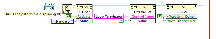

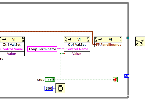

I do not have the time to dig into ControledGenerated tonight.  Here are screenshots of the changes to ControlingPredefined.
The Ctrl Val.Set sets the Loop Terminator to False so that Displaying.vi does not stop immediately the second time it runs.  Then the Run VI Invoke Node starts it running.
This shows the Close Reference and the Wait (ms) functions.  A simple rule for closing references is that if you opened it explicitly (as by Open), then close it.
Invoke and Property nodes can be slow, so often it is best to only write to them when something changes.  Writing Loop Terminator only when stop is True is one example.  Similarly, if all the images are the same size, only write to Final Picture: DrawAreaSize once.
