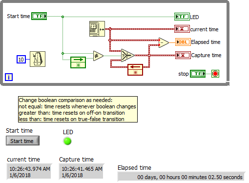

If you want the clock to continue, don't put the timing code inside a case structure that bypasses the code. Use shift registers to hold the capture time to reset the capture time every time the boolean goes on-off, for example. no local variables needed at all.

So you probably simply need another shift register to accumulate the total on time. try it!

Here's what I would do...
