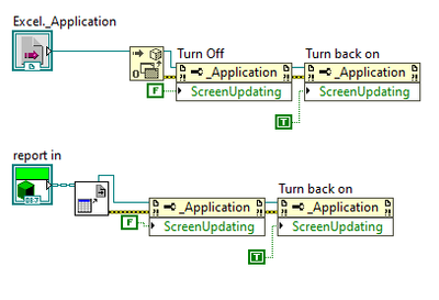

If you don't want to go down the XML route, all you have to do (likely) is just turn off screen updating in Excel. It'll be under the Application Class within that Excel Ref you have. Just turn it back on when you are done with a True constant.
Below is an example with using ActiveX Automation Open & the Get Excel ActiveX References from the Report Generation - Excel Specific - Excel Advanced - Get Excel ActiveX References. Both will work and will likely speed up entering data into your report.

Hello Eric,
I think your suggestion about Excel screen updating slowing the process down might be right.
I tried to create the code from your sketch and I couldn't make it. That's what I get:
When Excel._Application output is connected to Property node ref.num the class goes blank.
Now I suspect that there's something missing in my MS Office package installed on my PC.
Message 7 of 23

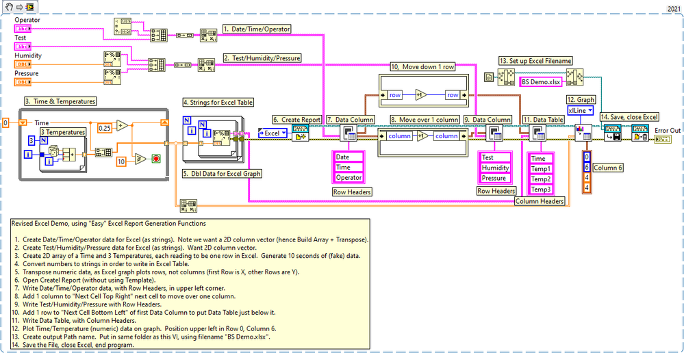

Hello, Alexander.
I think I may have a partial "solution" to your problem.  However, you'll need to do a little work with Excel to create a Workbook (with, I presume, a single Worksheet that, when printed, produces the report you want in the format you desire).  Let me take the steps one at a time.
The first thing I did was to print out your "Template".  It wasn't clear to me if you wanted a three-page "Landscape" report or a two-page "Portrait" report.  I chose the latter as it could fit on a single double-sided page, and seemed to "space out" nicely.
Excel works well when all the columns have the same spacing.  Your "Template" does not have that property.  Getting Excel to change column widths after, say, 92 rows to "fit a table" is painful.  Try to design your report so that all the column widths (including the table from Rows 94 to 100 are used for all the rows of the Report, as it will greatly simplify the Report "design".
Once you have the Template designed, I'm going to suggest you write your report without using a Template (don't panic, I'm about to show you how to do this).
Ten years ago (well, 10 years and one month ago), I posted a "Revised "Generate Excel Report" Example" in the Forums.  [You can find it by going to Google and starting to type "Revised "Generate Excel ... and it should pop up -- if it doesn't, try using the Search Bar in the Forums].  I'm about to post a very-slightly revised version here, so you won't even have to look for it -- the only change is that the RGT now uses "Create Report" instead of "New Report" used in 2014.
When you look at the Front Panel of this Report, you see a place to put certain entries.  Within the Report, I generate some fake data and list it in a table, and include it in an Excel Graph (you don't have to be this fancy).  I also show how to do some formatting, and to put data in the rows and columns where you want them.  Finally, I close the Report, having given it a name.  It took 4 seconds from start to finish, including opening and closing Excel.
I'm going to provide it as a LabVIEW 2021 Snippet, and will also the LabVIEW 2021 version of the VI.  You should be able to program this up yourself in almost any version of LabVIEW, as everything is visible and commented.
Bob Schor

@AlexanderU wrote:
Hello Eric,
I got that as well. Back when I observed this, I don't recall placing a CAR for it unless they resolved it in a later version (I'm running 2021 32-bit). I think it's the way LabVIEW tries to find the Excel EXE. You'll have to manually search for it and save it. Start at C:\Program Files\Microsoft Office.
