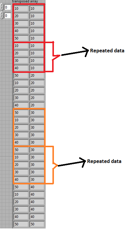

e.g I put the inital position for both to start at 10 and maximum position at 50. Can you tell me what is wrong there is repeated data. I need to finish this by today :(Thank alot!! I had done alot of attempt to fix it but it fail.

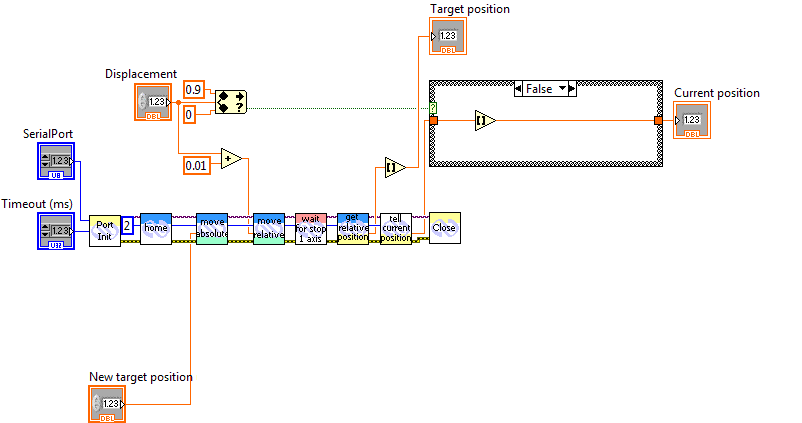

No there is no delay inside subvi. There is no data acquisition in the subvi. It is just simply setting the motor's position and the displacement. Those calculation code is just to make it as accurate as possible. The subvi is included in the image. Thank for your reply I added in the delay. How do I solve the problem I am encountering?

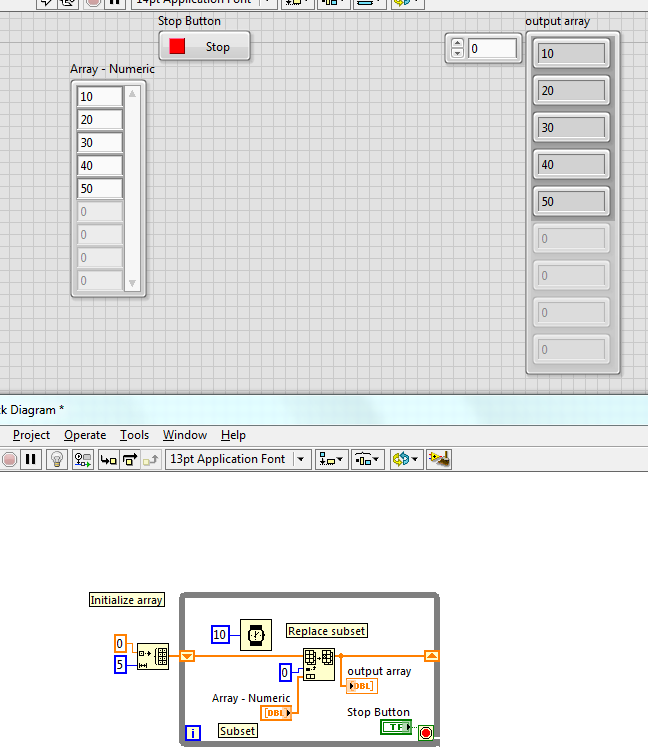

Is your problem that you get repeated data in your 2d array? Since you use the build array function and also connect it to the shift-register, you will get an array that will keep growing and growing and that is not good over time. You should use Replace array subset instead of build array. Note that you'll need to initialize the array first.

Yes my problem is the repeated data in 2D array, but another problem is also to ensure that the motor will not repeat the same data as I need to acquire data from my other equipment using the motor combination.
