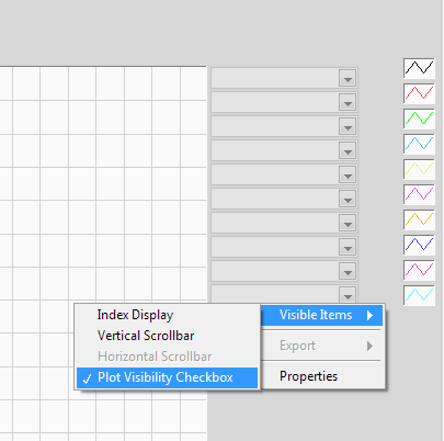

Here is the offending Graph.

Was it ever there?
Where did you get this graph from?
You probably need to just delete it and drop in a new graph.

I tried deleting and replacing the graph no luck
I have found Removing the Plot name from the legend causes the behavior.  Is this a bug or the desired functionality?

If I put a space in the plot name I can get it to work

Hello ASTDan,
It does appear that something odd happened when configuring this graph, my best guess is that someone attempted to hide the plot names and managed to lose the checkboxes as well - the ctl may even be partially corrupted, so as others have mentioned it may be a good idea to start fresh.
I was able to recover the names and checkboxes by toggling the "Plot Name Visible" Graph property, modified ctl attached.
