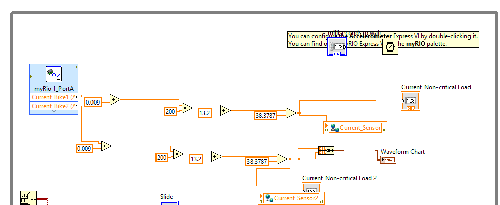

Hi there, I have two sensors for measurement and I would like the two datas from the sensors to be displayed on the chart on the NI dashboard, how do I do so? I've tried adding 2 plot in NI Dashboard chart, however it only shows one of the sensor data only.

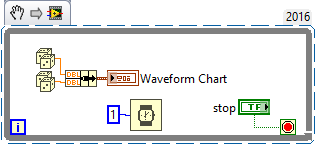

I have not used NI Dashboard before but I think it should work when you send bundled data from LabVIEW:
Let me know whether does it work with NI Dashboard?

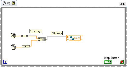

Multiple Plots on Charts and Graphs
You can now view multiplot data using the chart, graph, and XY graph. The chart and graph display 2D arrays of supported numeric values as multiplot data. The XY graph displays 2D arrays of points as multiplot data, where each point is a cluster that contains a pair of supported numeric values.  You can change the color of the plots by changing the color theme selected in the graph/chart properties. Sourced: https://decibel.ni.com/content/docs/DOC-29356
-So you need to ensure to create proper 2d array of data by getting data from each sensor and pass to chart.

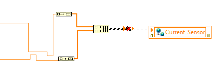

Is this the correct way to create the array?

Actually, that what you have created is called cluster, not an array, here you can read more about it:

The Data Dashboard chart will show multiple plots when given a 2D array of numerics.

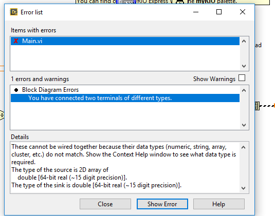

Hi Kracken, I've followed your example, but however, there's an error when connecting to shared variable. How to resolve it? Thanks.Untitled.png

How Do I Make a 2D Shared Variable? http://digital.ni.com/public.nsf/allkb/2206804A09D79A298625763800551E43
