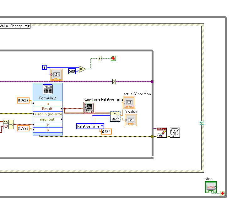

For you fast response, I tried to get it to work, but I don't understand
what value I have to connect to the "Get Wave Form XY" vi (see attachment)
I tried different values but it seems to samples only the last value...?

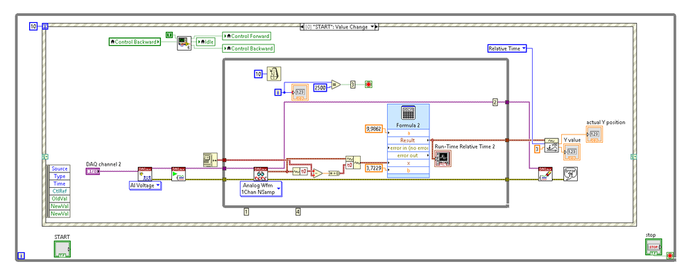

Hi GerdW,
I have 2500 samples, I tried your solution in a separate test vi, and then it worked
However when I placed it into my main setup, then it only shows the last value..
I think it has maybe something to do with the core "Run Time Relative Time" vi that I'm using?
(I found this vi on the NI Forum)
Message 7 of 9

  • Learn LabVIEW, especially the Principle of Data Flow.
  • Learn the major use of the Event Loop, handling changes in Front Panel controls.
  • Banish (!!) all local variables.  Learn LabVIEW, especially the use of Shift Registers to hold "local variables".
  • Remove the two "timing" features.
    • You don't need the Timeout Event if you understand how to use Value Change Events to keep the current value of Control Backward,  Control Forward, and Idle in a Shift Register.
    • Do you actually have a three-value State, Idle, Forward, or Backward?  Might an Enum represent this single quantity, with three Boolean controls changing the State?  Might make the logic cleaner (or maybe it won't ...).
    • You do not need a Timer Wait inside the DAQ loop -- the DAQ Read will have a far more accurate clock than Windows/LabVIEW (for one thing, no cycles will be "stolen" to do disk I/O, anti-virus testing, Windows update, etc.).
    • Learn LabVIEW, especially how DAQmx works.
  • It's curious how you are playing with t0 in your primary data cluster.  If you want relative time, all you need to do is to create (in your formula) your own clock, 0*dt, 1*dt, 2*dt, 3*dt, etc.
  • Data are sacred!!  Keep your data intact, and don't mess with its internal structure!
Bob Schor
