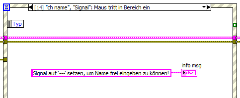

Example:
Showing a help message upon "mouse enter" event for two frontpanel elements. (The "mouse leave" event clears the message…)
