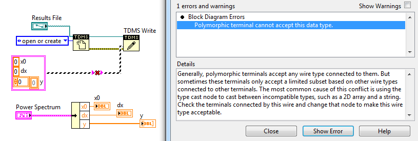

I don't understand. When I wire it directly I get an error.
Message 5 of 11
(5,347 Views)
Ah, I missed that its in the freq domain!

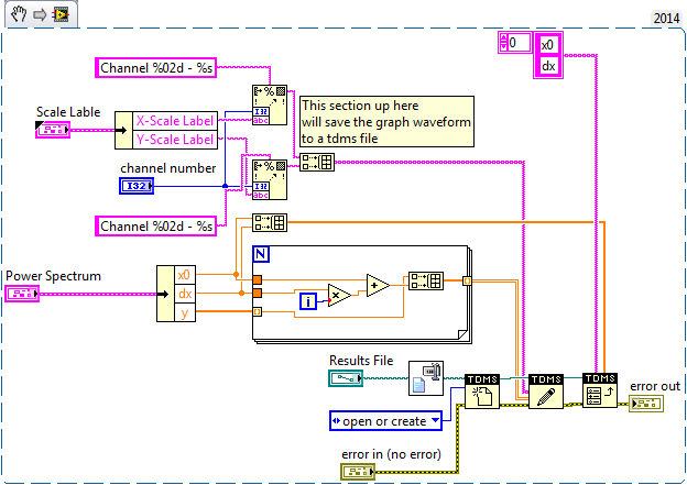

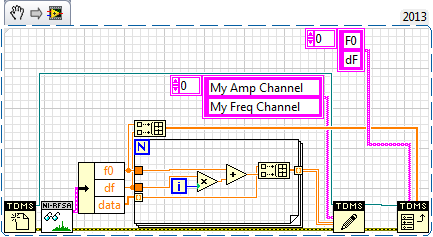

I would use something like this

I kudo'd you because I never knew that function existed, but am curious why the always copy is needed.  Also is a sub VI really needed for finding the size of the waveform?
(Speaking of the AC inside get waveform time array)
Probably because some improper buffer sharing bug used to exist and the subvi is likely used all over that library "Code it ONCE!"
The darn thing is hard to find on the palette with the screwy display name in the *mnu.  The palatte commitee overlooked that problem or had to compromize for some other localization.

Thank you! Just out of interest, how did you take that 'snippet' that I can drag onto a block diagram?

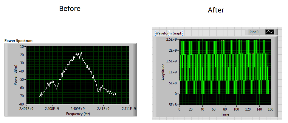

Hmm, is that correct? All is seems to do is mangle my data.
An example of the created TDMS file can be found here
Root Name Title Author Date/Time Groups Description dx x0
26.11.2014-10.23.45 _ TP-TRM-CA-05-C- TX Output Spectrum - 20dB Bandwidth_Data 1 10000 2478500000
Group Channels Description
Untitled 456
Untitled
Channel Datatype Unit Length Minimum Maximum Description NI_ArrayColumn Start Index
Channel 00 - Power (dBm) DT_DOUBLE 2 0
Channel 00 - Frequency (Hz) DT_DOUBLE 2 1
Untitled 2 DT_DOUBLE 158 2
Untitled 3 DT_DOUBLE 158 3
Untitled 4 DT_DOUBLE 158 4
Channel 01 - Power (dBm) DT_DOUBLE 2 0
Channel 01 - Frequency (Hz) DT_DOUBLE 2 1
Channel 02 - Power (dBm) DT_DOUBLE 2 0
Channel 02 - Frequency (Hz) DT_DOUBLE 2 1
Channel 03 - Power (dBm) DT_DOUBLE 2 0
Channel 03 - Frequency (Hz) DT_DOUBLE 2 1
Channel 04 - Power (dBm) DT_DOUBLE 2 0
Channel 04 - Frequency (Hz) DT_DOUBLE 2 1
Message 10 of 11
