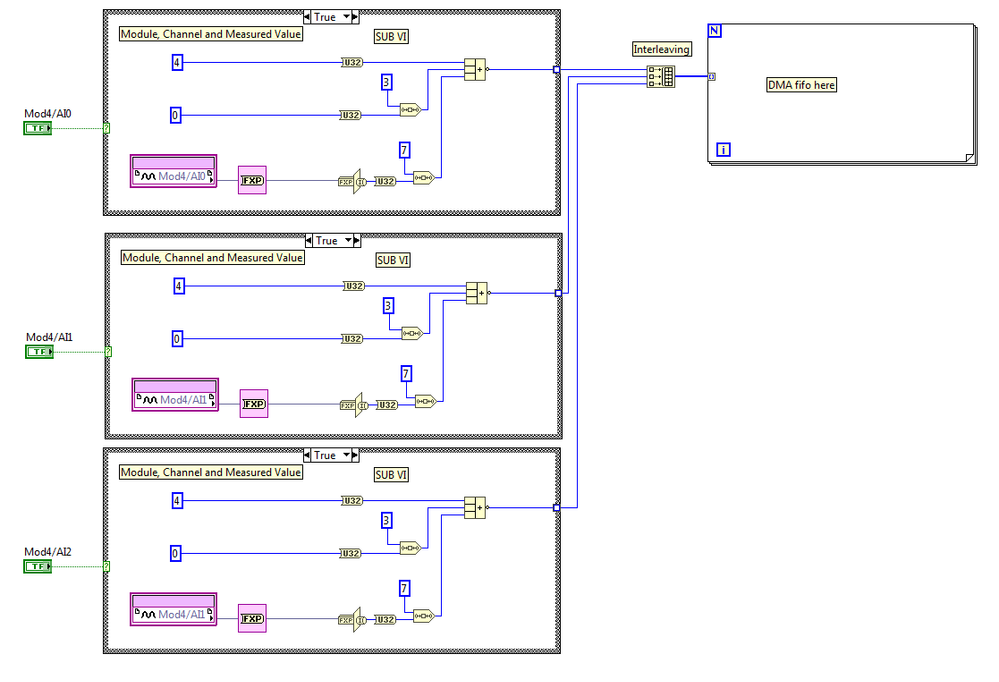

Sorry I wasn't all that clear. I want to interleave N channels to send through a DMA FIFO. The target end result is to have multiple channels (up to 8 voltage NI 9205, 8 current NI 9203, and a few custom channels). The user will then be able to select what channels he wants to be read and put through the DMA. The reason for wanting to do this programmatically on the FPGA side is to increase the possible logging frequency with lower number of channels, i.e. when using 1 voltage, the A/D converter is focusing solely on that single channel.
My initial plan was to use case structures, and some sort of interleaving:
But in this sort of design, I'll have to send through a zero or default number for the false cases, which will mean the DMA will alway be sending the same amount of information, regardless of the read speed of the module.

I think instead you will have to send an array of booleans as well to tell the for loop which ones to actually enqueue.
You could also read this from the host to know which channels are enabled as well if needed.
