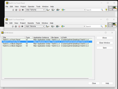

The problem could have been solved ( easily ? ) if more work had been put into the All Windows panel :
There should have been a Hide button too, next to the Show button. Just for a start. More fancy options could have been added too, like window front panel + block diagram pair grouping and and ..

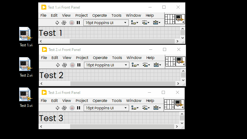

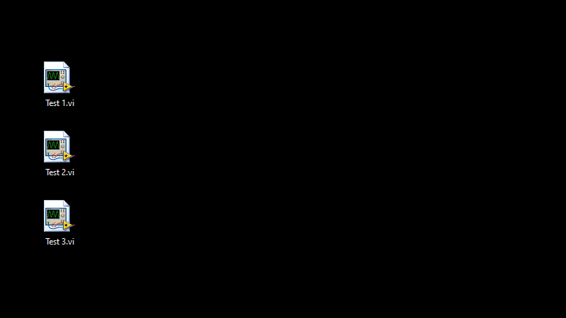

I have three VIs on the desktop and will open them in the order 3, 2, 1:
The windows are arranged in the list as 1, 2, 3, because every time a newly opened VI is placed on top, and the "Test 1" was opened last, hence this order.
Now I will minimize the first VI, then the second. Look what happens to that list:
When the first VI is minimized, the order changes to 2, 3, 1, and when the second is minimized, it changes to 3, 1, 2 (again — minimized VIs are placed at the end).
Now if I minimize the last third VI, the order will be 1, 2, 3.
And now the issue — if I click on VI 2 or 3, then this VI will be opened TOGETHER with 1 (which I don't want to see) because 1 is the first in the list. Let me demonstrate:
Obviously, if I close the VIs in the order 1, 2, 3, then open the first VI with a double-click, only this one will be opened as expected and no other annoying windows will be opened. Let me show this as well:
So, finally, this issue — if you get two opened windows depends on the order in which you minimized the windows. For example, if I want to get only VI 2 opened, then it needs to be minimized first, then the other two, and you will not have such a window:
But if the topmost VI in the list does not match the clicked VI, then you have both. For example, I can easily get 2 and 3 together, this is a problem:
It is an issue with how the double-click message is handled inside LabVIEW, seems to be nothing related to Windows. In my humble opinion, NI can fix it. You can also easily recognize in the last gif — when the "wrong" VI pops up, it always comes first, and then shortly after, the "correct one" is displayed. This delay is clearly recognizable.

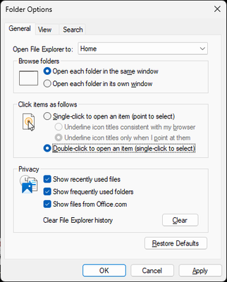

Uhm, how familiar are you with Windows? 🙂 Single-clicking selects a file, double-clicking "executes" it (or in case of non-executables opens the file with the program registered for its extension). I think there's some weird registry setting from the Win95/98 Explorer times to "execute" a file on a single click, but that would be extremely impractical. However, pressing "enter" after selecting a file in Explorer does the same thing as a double-click on it - with the exact same window restore behavior.
No weird registry setting, just a click in the Folder options. But I agree that this would be impractical.
