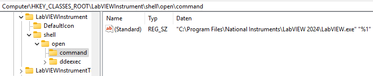

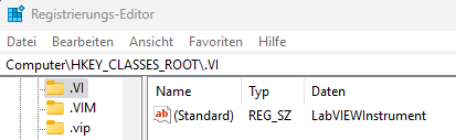

The *.VI file type is registered in Windows under the Registry key HKEY_CLASSES_ROOT\.VI:
Below also see the according LabVIEW Instrument entry:
when you double-click (or press Enter on) a VI file, Windows checks the extension from the first entry, proceeds to the second, and launches LabVIEW as if from the command line.
It’s important to understand that these two keys are updated every time LabVIEW starts. If you work with multiple LabVIEW versions, the most recently used version will always be launched-this is how LabVIEW “remembers” which version was last used.

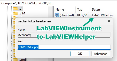

Anyway, let’s take everything into our own hands. The idea is simple: I’ll replace the «default» LabVIEW launcher with my own. This will also help me in the future to launch the correct LabVIEW version according to the VI’s saved version.
First, we’ll change the HKEY_CLASSES_ROOT\.VI (Default) key from LabVIEWInstrument to LabVIEWHelper:
But manual replacement replacement only works until the next LabVIEW start. Therefore, I’ll develop a small resident app that continuously overwrites this key (every 5 seconds). As I’m learning Rust, the code will be in Rust (you can do the same in LabVIEW). Not very elegant, but fine for a Sunday morning exercise:

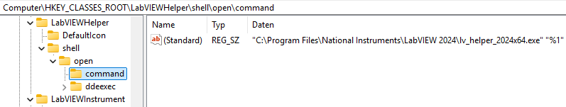

Next, we need a second Registry entry to launch our helper app:
complete registry file:
Spoiler
textWindows Registry Editor Version 5.00
[HKEY_CLASSES_ROOT\LabVIEWHelper]
@="LabVIEW Instrument"
[HKEY_CLASSES_ROOT\LabVIEWHelper\DefaultIcon]
@="C:\\Program Files\\National Instruments\\LabVIEW 2024\\LabVIEW.exe,-2"
[HKEY_CLASSES_ROOT\LabVIEWHelper\shell]
@="Open"
[HKEY_CLASSES_ROOT\LabVIEWHelper\shell\open]
@="&Open"
[HKEY_CLASSES_ROOT\LabVIEWHelper\shell\open\command]
@="\"C:\\Program Files\\National Instruments\\LabVIEW 2024\\lv_helper_2024x64.exe\" \"%1\""
[HKEY_CLASSES_ROOT\LabVIEWHelper\shell\open\ddeexec]
[HKEY_CLASSES_ROOT\LabVIEWHelper\shell\open\ddeexec\application]
[HKEY_CLASSES_ROOT\LabVIEWHelper\shell\open\ddeexec\ifexec]

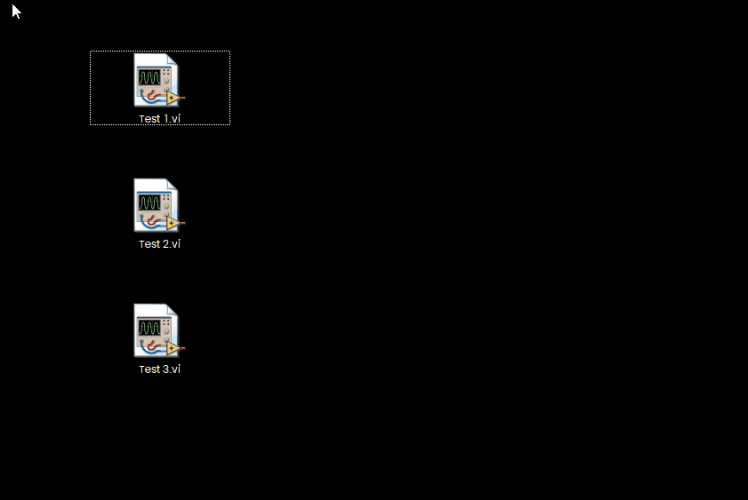

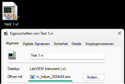

Now, instead of LabVIEW, my own application will be launched in the background:
this will launch LabVIEW, resolving the issue:

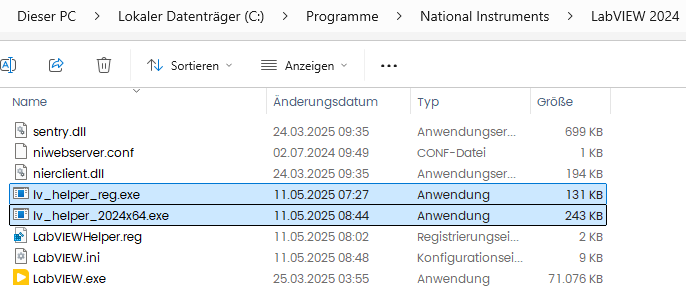

I’ll attach the complete code, executables, and reg files.
If you’d like to try:
Place both lv_helper_reg.exe and lv_helper_2024x64.exe into the LabVIEW folder:
Launch lv_helper_reg.exe, it will stay in memory, using 0% CPU and about 400 kB RAM:

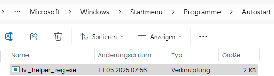

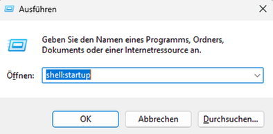

good idea to add it to the startup folder. The easiest way is to press Win+R then type `shell:startup`:
then place shortcut there:

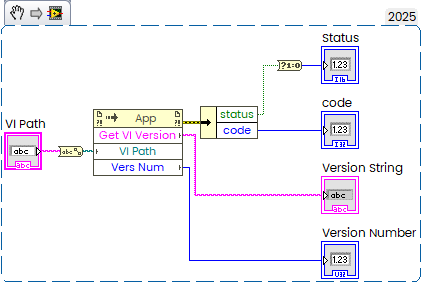

Now I've achieved what I wanted, with the help of a LabVIEW-written DLL
an and the following Rust code:

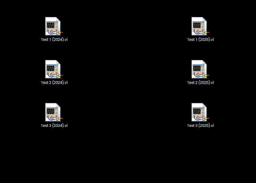

Not only this issue above fixed, but the launcher now automatically starts the correct LabVIEW version according to the VI's version-2024 for VIs saved in 2024, and 2025 for VIs saved in 2025.
No more annoying messages
and no more (or less at least) accidentally saving VIs in a higher version!
