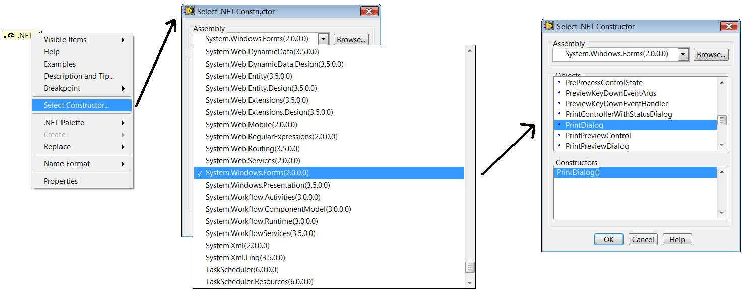

i have read that page...but i can't find Assembly System.Windows.Forms(2.0.0.0).

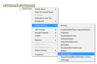

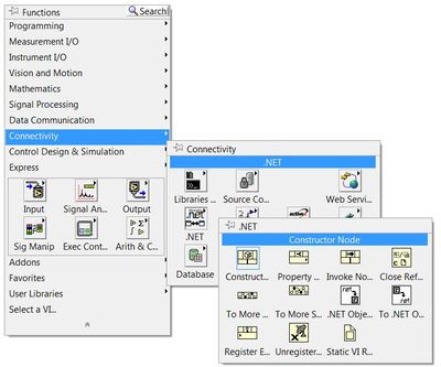

1) Put a .Net constructor node on your block diagram
2) Select the constructor
3)  Add an invoke node
