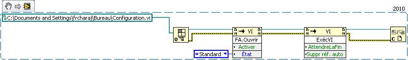

You can use the Execution Highligting to see what is happening and where are the differences between your first VI and the second one where you integrated your "configuration" sub-VI.
You also can call your sub-VI by calling it in using a property node:

thanks for your answer. I  found another systeme easiest , and for this time it is right but i will paste your code it looks like more sure.
Thanks for all
