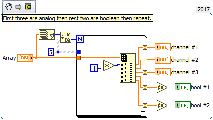

Hi suyash,
after going through some basic LabVIEW lessons you should be able to get to the very basic "index array elements in a loop approach":
(ReshapeArray and DecimateArray will also solve your problem, probably in a more optimized way. But still then you should understand the code you are writing…)
