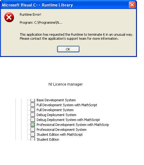

i had lv 861 on my pc and uninstalled it since i found the  "Data Entry" problems with 861.
but i didnt install the patch on the link http://joule.ni.com/nidu/cds/view/p/lang/en/id/1276
i've installed lv86 again and after installation i cant start lv.
even i saw an error ' microsoft visual c++ runtime error'from NI licence manager.
please see the attachment.
any help will be appreciated.

First I would like to know which O/S you are using.
Maybe the Runtime Engine exe file is corrupt in the CD you are using to install LabVIEW.
In this case download LabVIEW Runtime Engine 8.6 from http://joule.ni.com/nidu/cds/view/p/id/1101/lang/en
I hope this can already help. If not, I am pretty sure, that the only solution we can find is to uninstall all NI Products and re-install all in the right order. For uninstallation I can give you a document which describes the best way to uninstall all NI products from your system completely and afterwards re-install them correctly. First install LV and then the patches and drivers. It is very important that LV is the first software you install.
I hope it works. Before you uninstall read the following topics in this forum, these are very similar problems. But I think, you cannot avoid a re-installation. Maybe you even have to re-istall Windows!

Thank you all... i can't reinstall all the versions since 7.0 'cause of short of time.
i've reinstalled 861 with patch and it works!
thanking you all again, especially Matteo for his support
