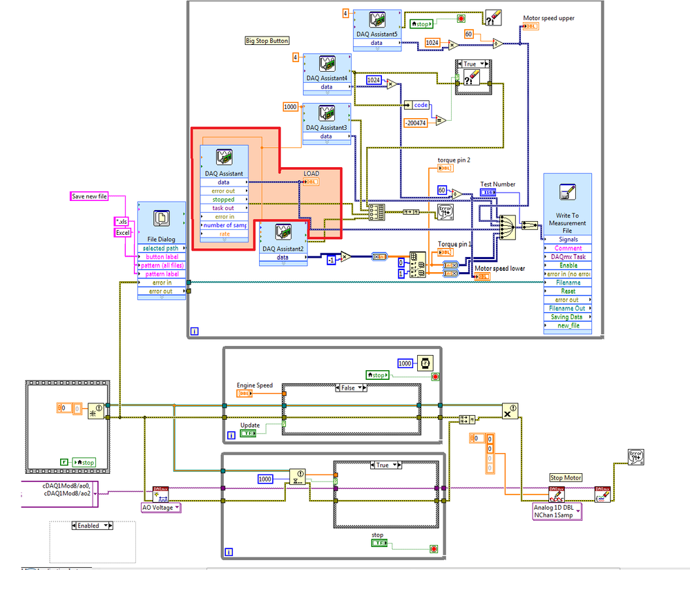

I have a program to command 2 motors and collect the speed of each axis and the load applied between them.
The hardware works well (checked all the sensors) and the program worked well until 5 days...

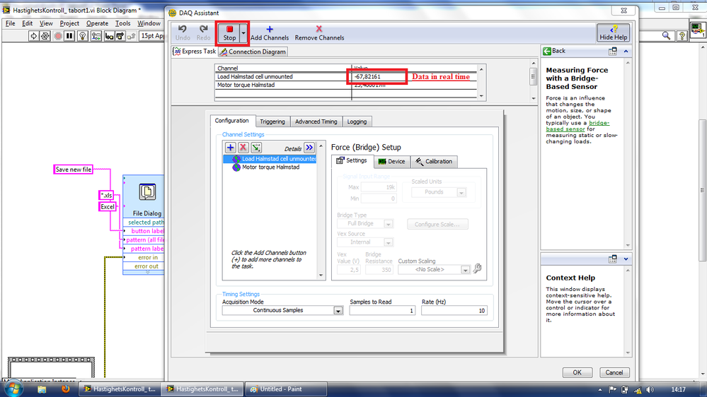

Now my problem is : I want to see the load in real time (using a DBL numeric indicator linked to a DAQ Assistant that just collect the load datas)
AND in the DAQ Assistant (double click on it), in see the load in real time when i use the button "RUN/STOP"
but on  the front panel, when i click on the button "RUN" the indicator is just fix on the first value and doesn't indicate anything...

A couple of things.  I would change your DAQ setup for the force to be "1 Sample (On Demand)", because it appears that you are only reading one sample every time you go through the loop.  I would think your other DAQ setups need this too.
I also assume that you are using the loop speed to control the sample rate of your acquisition of the other data channels.
Is all of your acquisition occuring from one card or seperate cards?  Some cards don't allow simulatenous tasks/acquisition.  I guess the DAQ assistant takes care of that.

Sometimes simplest answers are the bests.... THANK YOU. It works, it was separated cards and I think someone just touched the settings of the DAQ and yeah I didn't see that. Stupid errror, I will remember that the next time. 😃
