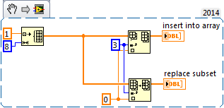

Insert into array will increase the size of the array and therefore anything that comes after your insert index will have it's index increased by the number of elements you are inserting.
If you want to replace an element in an array - use 'replace array subset'.
Here's an example:
Output:

Hi cllorab
If you use a "Insert into Array" function, then it Inserts an element into n-dim array at the point you specify in index, thereby moving down the other elements.
If you use " Replace Array Subset" Function, then Replaces an element or subarray in an array at the point you specify in index.
