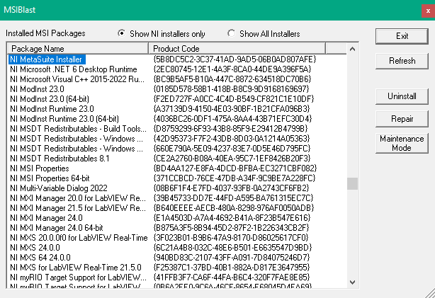

Not sure if this help or not, but you can try to use MSIBlast if nothing else helps. Can be found here on forum —  link to download of msiblast or also attached to this message.
I've used this in the past long long time ago one or two times to uninstall particular specific product. Use it very accurately and carefully, because you can easily mess up and damage everything, in worst case you will need to reinstall everything from the scratch. This is non-official and unsupported tool.
