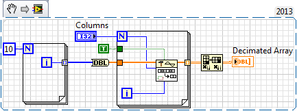

decimate, build (do not concat) and transpose
Those functions on the array manipulation palatte can be fairly helpful.  A quick look through the help is in order.
Spoiler
Now wait for altenbach to do this on a postage stamp using CDB data

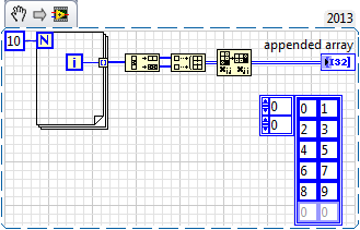

Or, if you need to scale it up to an arbitrary number of columns the Signal operations palatte has a real gem.
(3,763 Views)
Or you could just use Reshape Array...
