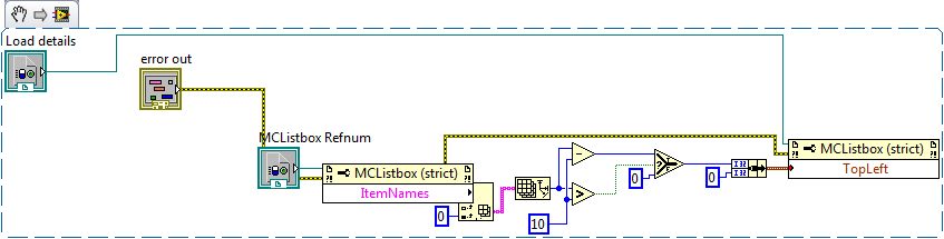

This is how to do it with a multicolumn listbox:
The MListBox displays a maximum of 10 rows.  If the MListBox contains more than 10 rows then it adjusts (No of rows - 10) the TopLeft hand view (i.e. scrolls).
