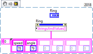

Accepted by topic author AeroSoul
Note that his doesn't work with an enum control. Enum's look like rings, but there items are part of the type, and can't be changed when the control is running.

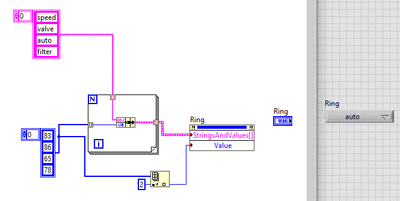

Played around a bit and you can set the value to display programmatically by using Property Node --> Value and wire one of the values you input to StringsAndValues[].
Quick demo:
