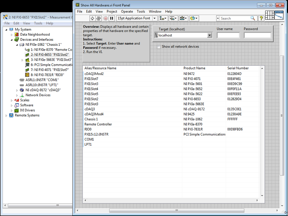

I would suggest using NI System Configuration. It should return information for anything that shows up in MAX and it exposes an "Is Present" attribute if you need to detect if something is currently connected.
It includes a LV shipping example called Show All Hardware that you can use as a starting point and you can also use NI System Configuration to rename, self-test, self-calibrate, and reset devices just like you can from MAX.
