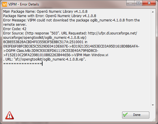

I go through the same process, but it errors out saying it can't access the remote server.
Message 27 of 31
(1,485 Views)
Here's an example of what I am getting for an error
Message 28 of 31
(1,482 Views)
Odd.  First thought is that something is wrong with the server.  But I was able to install it just fine to my LabVIEW 2016 version.
Is it possible your corporate network is blocking access to sourceforge?  But there is some communication going on.
Message 29 of 31
(1,480 Views)
Checking on this. I know I had to request access for the download, so maybe they are still blocking parts of this.
