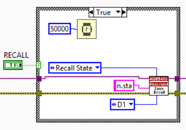

Say, I have a case structure like this:
what it does is just send command to the machine to perform some task, the machine then take some time to do that task, however does not have any feedback to tell labview that when the task is done. So the timer value is just the time estimated for performing task.

Instead of a 50 second wait.  Put a 1 second wait in a For Loop that is set to run 50 iterations.   Let the iteration number update the progress bar.
Unfortunately you have no direct connection between the progress bar and what is the actual status of what is going on inside that subVI.  If that subVI ends in 2 seconds, the loop is still going to take 50 seconds.  If the subVI takes 70 seconds, the progress bar will stop updating after 50 seconds, and you still have to wait another dead 20 seconds.
You could set up a while loop, and use a notifier to tell the while loop when to stop iterating.  When the subVI exits have it send the notification to the while loop to tell it to stop iterating and stop updating the progress bar.
This situation seems to be off-topic, but is there any way to know that when the task is done? As by progress bar ?
Probably should note that that wait time is simply that... a wait time.  You're telling the code to wait 50 seconds.  Whether or not that task is done before, during, or after the wait is strictly up to LabVIEW, but you will be waiting 50 seconds no matter what.  For a "timer progress bar" you need to have the timer in a separate loop that just sits there and counts when you enter a certain state (which in this case looks like Recall Save).  Although, technically... they could be in the same loop as long as you program it correctly where the action is not included in that timer loop.
