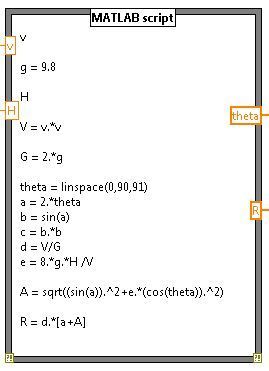

I am trying to draw a projectile motion graph using MATLAB script. But not getting the graph. Can anyone please check my code and tell me what is the mistake.
I don't know how to take θ positive and negative when above and below the horizontal. How can I write the code for it?

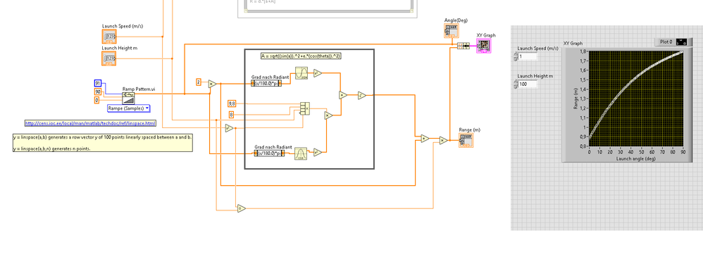

I hastly translated your script in plain Labview G code, this is what I get:
Message 2 of 11
(11,837 Views)

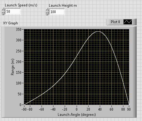

This has nothing to do with LabVIEW, BUT...
If you shoot a projectile with a launch angle of 90deg (straight up in the air), it should come down on your head. Your result shows it landing quite a long distance away. So, I think your equation is wrong in the Matlab Script.

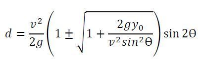

Got this equation from Wikipedia
Rearranging the terms to match your MathScript code, I get the following for "R":
R = d.*[sin(a)+A]
It's different than what you have. Try it and see if the results are more realistic.

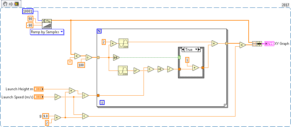

This got me thinking a little more. The Wikipedia formula doesn't model the motion well for negative launch angles. Going back to the quadratic equation, there are actually 2 solutions for the range. You need to use the "plus" for positive angles and "minus" for negative angles.quad solution.jpg
Here is a quick VI implementing positive/negative launch angle
Message 7 of 11
(11,779 Views)
I think it translates to your Matlab script as (please check my math):
R=d.*[sin(a)+A]   for theta>0
R=d.*[sin(a)-A]   for theta<0
and for special case of theta=0
R=v*sqrt(2*H/g)
