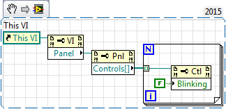

@MinerHokieRamp wrote:
Is there not a way to globally initialize the blinking properties to false when the VI first runs?
You can iterate through all of your FP controls and write a false constant to blinking which will have the effect of stopping the blinking effect for all FP controls and indicators.
Message 5 of 11
(3,732 Views)
Keep in mind the posted method won't go inside other controls.  So if you have a blinking control in a tab then it won't be turned off.  Same with if something is blinking in a cluster.  For these types of controls you should use the Traverse For GObjects.
Fantastic! It works! So, maybe I shouldn't have asked this question in the prior thread. How do I give you solution/kudos credit in this case? I suppose the moderator could provide some direction.
