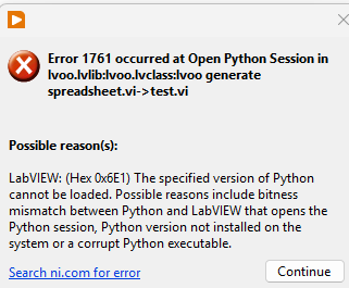

using their project and running test.vi (following their instructions) I get error 1761
forum posts say it could be the environmental variables:
PYTHONPATH
C:\Program Files (x86)\LibreOffice\program
C:\Program Files (x86)\LibreOffice\program\python-core-3.10.17\lib
URE_BOOTSTRAP
vnd.sun.star.pathname:C:/Program Files (x86)/LibreOffice/program/fundamental.ini
I narrowed it down to the 'open python session.vi' but even if I connect the correct python version, 3.1 and path directly it still has the same error
has anyone tried this and copy me their environmental variable for comparison. Otherwise I assume it's not compatible with W11 😫

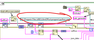

got it working with W11 - hope this helps with anyone else having problems!
In 'lvoo generate spreadsheet.vi' I explicitly added the python.exe path for 'open python session'
so I assume W11 handles environment variables subtly differently??
