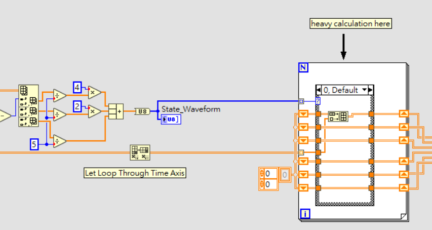

One of the NI 9215 reads Rx data continuously while Tx is switching, so i need to separate these data into N part(N = Tx number) according to the pattern from analog output.
The way i separate data is using case structure, but it's getting slow as the sample rate growing and can't enable loop iteration parallelism.
So i wonder if there is a better way to separate data, or maybe other way to deal with RF-Switch control?
To simulate this question , i attach my VI example.

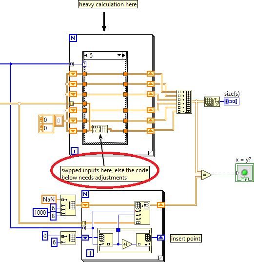

I assume you know the final size, so you can initialize it at once at that size (if you are worried to be able to tell if it is real data or not, initialize with NaN), the put it in a single shift register and replace sections at the right places as required.
(2,870 Views)
Accepted by topic author Andy_lai
Here's how that could look like. Bottom loop. (initialize once at final size. All in-place after that)
I swapped the inputs for the bottom array in your code (top) (where you were pre-pending instead of appending) and the results agree after that.
If you really want to build the lowest array of the six in the other direction, adjustments are needed.
(Depending on how much symmetry is in the index data, it could probably be simplfied further, of course).
