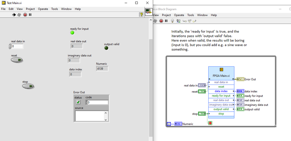

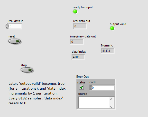

Attached is a project that uses the Desktop Execution Node to demonstrate this (LabVIEW 2019, with a cRIO-9045 in the project, no hardware required).
Below are a couple of images with 0 inputs. I modified the project after to use a sine + random value to get a marginally more interesting output...
During Initialization, 'output valid' is false.During Initialization, 'output valid' is false.Later, it becomes true, and 'data index' gives the location within the current block.Later, it becomes true, and 'data index' gives the location within the current block.
