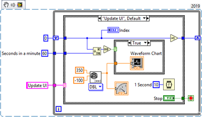

@Cannon_Controls wrote:
Yes, that was my initial thought. I just wasn't sure how to implement that with my current setup.
I think @Bob_Schor described how to implement it.
@Bob_Schor wrote:
Count the points, and save every 60th (or once/minute).
Something like this:
Notes on the case structures.
  • "Update UI", Default is the only case in the outer case of the snippet. (You would wire the "index" shift register through each case. Retain the value, only increment when you get a new data point.)
  • The False case in the inner case structure is completely empty.
Output_every_60th_value_JoB_Empty_False.pngOutput_every_60th_value_JoB_Empty_False.png
(I took the liberty of only using a 10 ms wait to make this example easier to see when running.)
Does this make sense?
-joeorbob

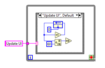

I just looked at what I posted...If you only need to use it in the "Update UI" case, you can replace the shift register with one of these:
Spoiler
Either one would simplify the diagram by pulling the Shift Register out so that the other cases didn't need it.
A better solution might be to use Time to track how often you need to save off data - it would be less dependent on magic numbers (like 60 and a Wait (ms) of 1000) and could save off the data every minute, independent of any loop timing changes.
-joeorbob
