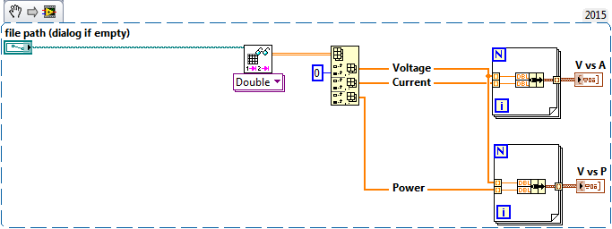

Try this
Palanivel Thiruvenkadam | பழனிவேல் திருவெங்கடம்
LabVIEW™ Champion |Certified LabVIEW™ Architect |Certified TestStand Developer
Kidlin's Law -If you can write the problem down clearly then the matter is half solved.
Message 3 of 10
(4,233 Views)

Hi Palanivel,
what are those FOR loops good for? You don't need them…
Message 5 of 10
(4,227 Views)

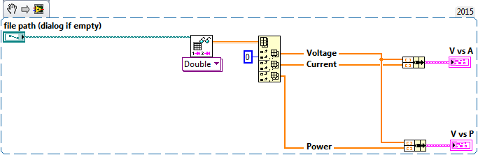

Hi Gerd You are rite... Thanks for reminding.

Hi Palanivel,
                   Thanks for the help. The only thing I could not find was the figures attached to the For Loops. Are they supposed to X-Y Graph symbols of something else?
Thanks.
Vince
Message 7 of 10
(4,206 Views)
Hi Vince,
you want to plot "x vs. y" data, so you should use XY graphs!
Message 8 of 10
(4,194 Views)
Accepted by topic author SSHADOR
Huray!!, it worked. thanks to everyone who helped. Vince.
