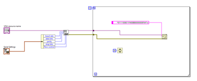

I need to send data frame to configure and start an instrument. I use RS-232 communication.
My data frame is long  ( 01111008011F400BB80000000F04 ). It contains several pieces of information. I tried to use the examples contained in the labview library but it does not work.
Is it possible to get some advice please?

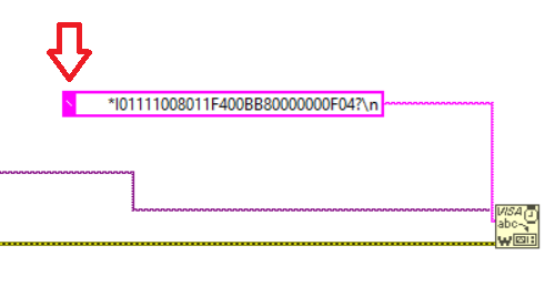

You still haven't explained if the data you describe is in ASCII hex or binary hex. ASCII hex is what you try to send in the VI (plus some +I prefix and ?\n postfix).
Where do these prefix and postfix come from?

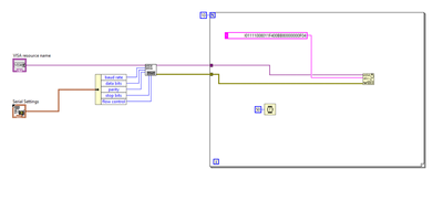

Currently, i would lik to use LabView to send this data frame in hexadecimal to this instrument. The example I found in the LabView library, I modified to write to the buffer of the Visa Write block but it does not work even if I do not have error messages.

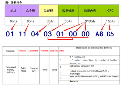

Programming manual that I found and which allowed me to control this instrument with another software.

But your string is ASCII hex, not binary hex as indicated by your documents. In that document it clearly says that those 0x01 0x11 0x04 ... are 8 bit values. You send them as ASCII resulting in two 8-bit values being send for each of them. Then wrap it also in some *I and ?\n, probably based on some other posts you found somewhere talking about normal instrument communication that usually happens through ASCII string commands.
Try to change your string constant to Hex Display Mode instead and enter that string again. Alternatively you could create an array of U8 values, change the Radix to hex and enter those values in there, then use a Byte Array To String conversion to get the binary string that the VISA Write expects.
The string seems to be in \-codes. As a first step I would recommend to change the string to hex display and re-enter the data.

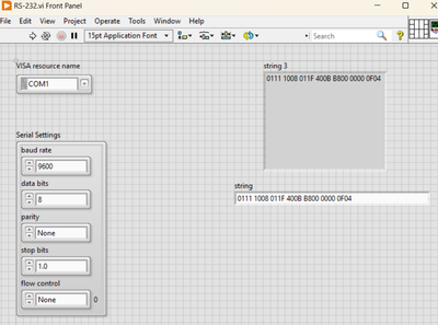

I changed the radex of the block control to hexadecimal output and I put this data frame in a U8 array. Then i converted to hexadecimal. Should i put these bytes one by one please?
