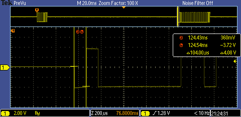

Thanks for the feedback Themanual approach using DTR does provide a solution.
We found out that with 2-wire Auto there is absolutely no idle time between the switch to transmit mode and thestart bit. Nothing....
Which seems quite dangerous. It might explain why some equipment is unable to read the traffic withour errors. I would love to hear from NI if thatis how it is supposed to be.Here is how it looks with auto:
There is no transition, the start bit just comes straigt away, followed by a 10000000.

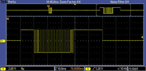

Now, keeping everything else constant (termination etc.), we are indeed able to set the time by controlling DTR. If we set DTR to asserted 10 ms prior to VISA Write, and wait 50 ms afterwards before setting DTR to unasserted, we get this:
This looks much nicer.
Now one other thing that bothers me with this is that when you do a VISA write it sill return immediately, so if you just use data flow to set the DTR to unasserted you end up cutting off the transmission before even a single byte has been transmitted. This effect is illustrated above by the fact that the transmit mode stops about 50 ms after the start of the transmission, not 50 ms after the end...
To avoid corrupting the transmission we have to calculate th time it will take to actually push the given message out on the port at the given baud rate (based on its length), then insert a wait between the VISA Write and the DTR property node that corresponds to that time....It would have been much safer and more flexible if the DTR propertydid not execute untilthe write operation was safely completed.
