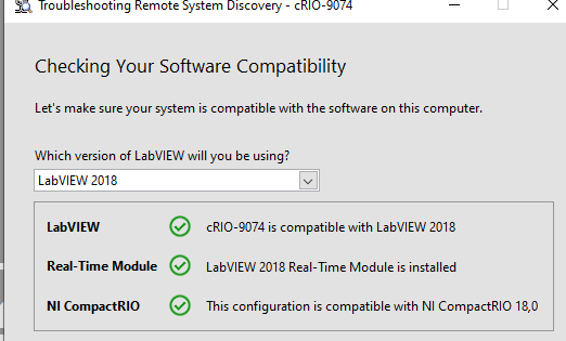

And the biggest mystery is why the system claims that the RT module is not installed. In the list of programs, which you can find in my first message, RT is displayed. Moreover, if I try to install the module, I get a message that there is nothing to install.
To test it, I ran the same problem solver and all the lines are green on my machine.
