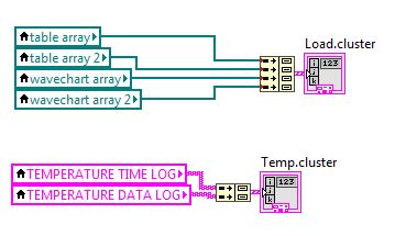

Hey cbutcher,
Ive tried creating those clusters but I dont really understand what you meant by this
"In this case, you should probably consider a Cluster containing all of your arrays, which you can then use on the Shift Register. When you want to write the values, use Bundle By Name, and when you want to access the data, use Unbundle by Name. You can use simply Bundle and Unbundle if you want,"
I am not sure how to go about doing it. I have tried switching those feedback nodes back to shift registers and indeed, the wires are all over the place.
Attached is my cluster, let me know if I am right or wrong 🙂
Cheers !

Jarrold wrote:Is it possible for you to show me an example so that i can better relate and learn from it, cbutcher?
Yes. I'm attaching your VI (possibly you've made improvements since this copy, but hopefully you can see the idea and just implement it in your code if you have) with a cluster for Time and Temp measurements. The cluster is defined in the case that measures the temperature (but it probably shouldn't be!) and then a Linked Input Tunnel is used to ensure the wire is passed by default through other cases.
The reset case wires empty arrays to both in the Bundle By Name node we discussed.
You should make the cluster a typedef (right click on the little pink box and click Make Type Def.) and add it to your project. You can do similar things for the readings on other panels, hopefully allowing you to reclaim some of your screen space 🙂
I also removed the confusing (to me) loop for the Time Array. Hopefully it still does what you want, if not, just use what you already have. I use a Build Array with only one input to make a 2D array if you want that display - I didn't really understand what you meant in your recent post about the 1D/2D indicator, so I wasn't sure which you wanted.
