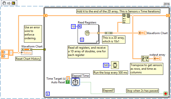

I'm pretty sure you can solve your array/wavechart problem of not updating properly by inserting a Build Array node in the output - so that the 1D array becomes 2D. Don't expand the node - just have a single input and the one output. This should make your chart do what you want (I think - maybe I still don't understand what you want)
Regarding running the code - no, sorry. I don't have the hardware to make this work. I could probably try and hook it up to the machine tool I do have access to, but I'm not going to do that 😉 I have enough problems with it without accidentally destroying the parameter set or something 😛
I think a point you might be missing, is that the outputs from the while loop don't output a value every iteration. Outputs from a loop only output their values once the loop finishes running. For solid squares, they output the last, most recent value. For the [] boxes, they output an array of values - this is what you're using with the Read Single Address VI. But it's important to know, they aren't sent one at a time - they come as a block, once the loop finishes.

This example snippet might be helpful.

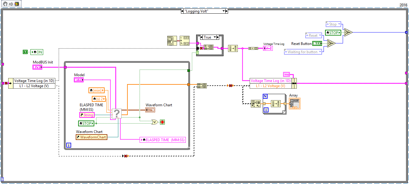

  • You should try where possible (which is almost always possible) to have wires go from left to right. This convention makes it much clearer which are inputs and which are outputs. For example, in your Logging Volt case, I moved some of the parts around, removed some empty For loops and Build Arrays, and shuffled the boolean and array outputs to the right side of the inner While loop. Hopefully you'll agree it's a little easier to read (some broken wires, these are because I don't have typedefs. They're attached in the VI).

By the way, I also attached one diagram and would like to know how can i simplify it. I am sure there is a way but due to my lack of experience, I am unable to design a simplified circuit with similar function. Please enlighten me ! 🙂

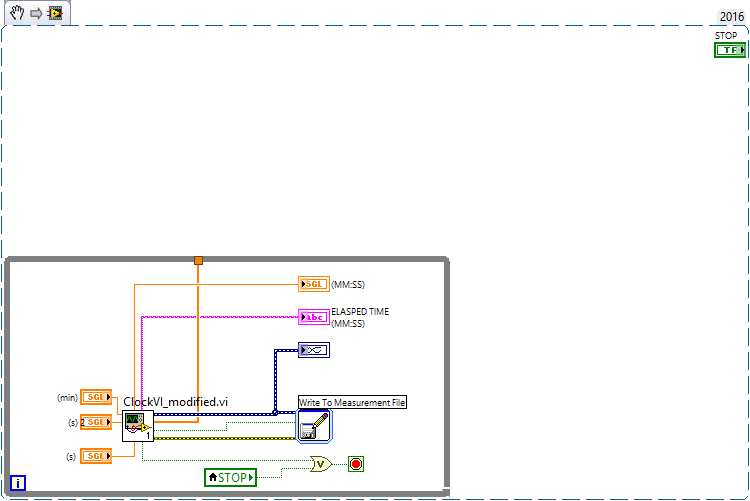

Here's my attempt at the ClockVI with some modifications - basically I just removed the loop. Can you check to see if it does what you want? You'll also need this snippet probably 🙂
Edit: Depending on how your measurement works, you might need to right click on the tunnel out of the loop and change the mode to Concatenating.
