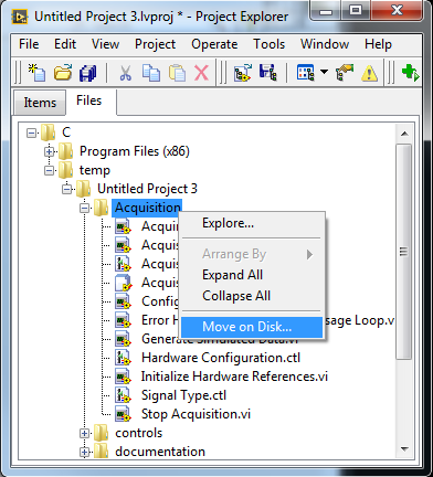

My advice is to never move libraries or classes on disk.
But if you *have* to, I've had decent luck using the "Move on Disk" option in the Files view of the Project Explorer..it appears to fix up linkages ok:

If I wanted the whole directry, then I would probable have been able to do this.
Since the testing I was doing required adding and removing sub-objects from certain other objects in order to find the optimal performance  versus usability I ended up with several orphan VIs.  VIs which are in the same directory as a class but aren't actually part of it any more.  Testing was a really hectic time and I was often not sure at all if I would be able to meed the requirements (including investigating some seemingly weird benchmark results due in part to faulty RT deploys).  So moving from this exploratory phase and trying to re-use as much of the code I have prodiced I tried to clean things up: i.e. only copy over the files which actually belong to the class, leaving the poor old orphans behind to meet their doom.
Even the ability to select multiple files in the project view and then switch over to the files view to move them on disk would be a cool addition.  that way I can select all of the real class members, switch view and move the files.  It's exactly this "files which are in the class and no others" part which I miss sorely.
