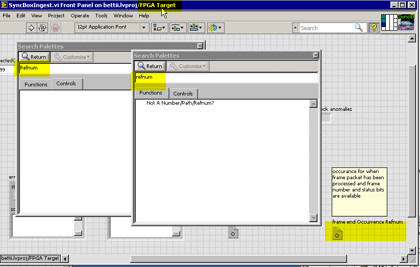

You are correct that I do not have that node in my palette.  However, I also don't seem to have an Occurrence Refnum in the palette either in FPGA mode (see below), but I needed it to synchronize multiple FPGA loops and was able to add it using the search textfield in the VI editor (and if compiles and runs).  So 6 months in to Labview and I'm fuzzy about how the palette is constrained.
I'm not sure what you're trying to demonstrate here. There's no refnum control in the search box in your image . Occurrences are available in FPGA, and to get a refnum control for one you just right-click on an occurrence function and create a control. If you can create a valid wire of a certain datatype, then you can create a control or indicator for it, regardless of whether that control or indicator type appears in the palettes. However, the functions you can use in the block diagram are limited by what's available in the palettes.
