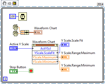

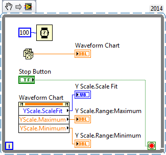

There is a YScale sub-menu when browsing for properties. This includes the Range maximum, minimum, etc.The auto-scale property is in the form of "YScale.ScaleFit".
These properties do change when the user zooms, or manually types in to the ranges.
Try this out:
Cheers

Accepted by topic author xl600
If you have stacked plots, you need to write to the Active Y Scale property to read the scale information for that specific plot.
Cheers
(5,565 Views)
Thanks, that was the thing I was missing.  I have another VI which was changing the active Y axis in an event that I didn't spot.  It was changing it back to defaults for that axis (Based on a global set of axis settings).
