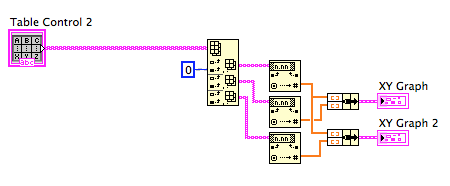

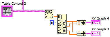

1. A table is a good way to have a user enter data. You can show column headers and place labels there which will prompt the users to put the data in the correct columns.
2. Because the table is a string control, you may need to validate the results before passing it to the power supply. If someone types "five volts" into the second column, the numerical output will be zero.
3. If you want the wait times to represent intervals rather than specific time of day or elapsed time in the experiment, then you need to add the intervals to create a cumulative time.
You do not need to index column zero a second time and convert that string array to numeric a second time. Just branch the wire. The code in both of these images produces the same graphs as yours.

Hi yes... I have done several tutorials and a lot of different application but here I stuck.
I tried also with "for loop" like this but as I told it before I have problems with auto inceremnting of rows for Time, Voltage, Current.
@ I think your last picture can not be used in my case as I need to define row and column for example excact value of voltage,current, time... (except for graphs ) -> thank you for that idea !

2. I don't understand graphs 3&4

2. Graphs 3 and 4 have exactly the same data as graphs 1 and 2 except that the x-axis values are the sum of the values in column 1. I did make one mistake which causes the graph to start at the end of the first time rather than zero. The attached VI corrects that.
I also changed the interpolation style on the graphs to show the voltage versus time more realistically.
3. The table is a string control. The user can type anything into the control. You can test what is entered in software and pop up a dialog telling the user to enter something acceptable or overwrite the data.  This can be somewhat simple or quite complex, depending on what you need to do.
4. This is what I show in graphs 3 and 4 and on the meters at the output.
